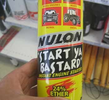

There are times when I despair of myself. Today I did something very stupid and now I need some help. I am so annoyed with myself that like the family of the Elephant's Child I should be spanked until I am "very warm and greatly astonished". I was cleaning up the gelcoated interior of the tub of my SR in readiness for painting. A previous owner had used a very tough glue to fit some carpet into the area behind the seats. I used every solvent that I had in the shed and found that a combination of scraping, acetone and ether was working, but it was slow and difficult. Because brake fluid will take the hair off a brown dog I tried some of that. Silly me. It did no good but now I have contaminated the area with an oil which I am having trouble removing. I have used the following solvents to try to remove it Petrol (gasolene). white spirit, mineral turpentine, metholated spirits, ether (from aerostart or as it is labeled here, "Start ya Bastard!", acetone and lacquer thinners. None of it has worked. What do you suggest that I try next?

WuZaBuG. Sure I can send you some Start ya Bastard, but I doubt if it would be permissable to send something as inflamably potent as ether in the mail. PM me your snail mail address. The label is painted on the can and I don't expect to finish my can for a long time as I don't use it very often. Let me see what I can do.
