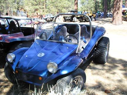

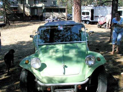

For wahtever reason you want an opening hood, here are some possibilities (none hinge from the front), that still require a lot of work... These would avoid most of the previously mentioned problems (except #5) and require some sort of 'Lip' fabrication for a nice fit and latch or hood pins or something to keep it closed. Image Image This orange one is, I think, from Europe and looks to have the headlights mounted on the hood. I believe I read that the hinge and fiberglass work was done by the owner, pretty nice 'Lip' work. Image Image Like I said, lots of work to make it "right", not sure what benefit you're looking for... please enlighten us on "why" you want to do this (you might have an original idea that's neat!). Are you moving the gas tank to the rear for storage under the hood? Remember, you can do anything you want, it's your buggy! It just takes some combination of time, skill & $$$.

The orange opening hood shown in the earlier post was made and sold by Bruce Meyers. They were listed in Volumes III and IV (2000 and 2001) of Manx Mania and sold for $275. They were basically the same hood that was used on the monocoque manx's, which hinged open. Take a close look at a picture of Old Red and You'll see. Image

Wow, thanks for correcting me on this piece of Manx history. Now I know why the lip fit is so nice. Thanks.
