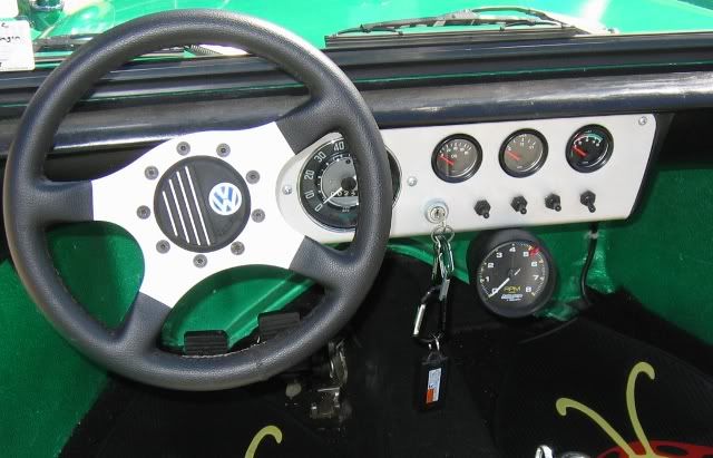

Here's mine, pretty basic....but works great. I had the panel clear anodized :D Image
GregR
