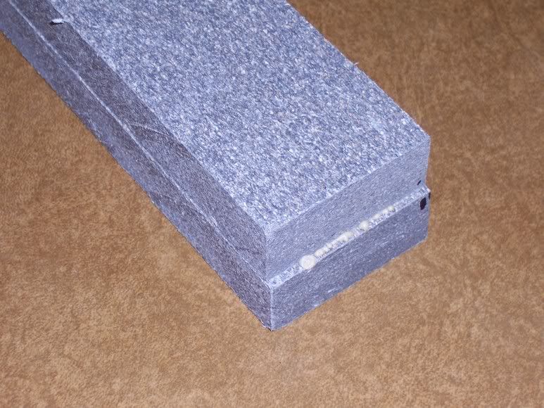

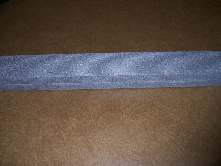

Well I bought the stuff and am very very impressed with it. Here are a couple of pics of the first pieces I made. They are ripped and then glued (Liquid Nails) together, they need to be ripped again after the glueing. I have to wait until tonight to borrow a router to shape the inner edge for the body lip. This stuff works much nicer than wood and is consistant all the way through and sands very, very smooth. It won't rust or rot either. It is very dense. On the down side it is pretty heavy. Might get the hole saw after it once I get it done. Did I mention I love this stuff? :D Image Image

The composite does look good, I can't wait to see how it looks after you take the router to it. Keep us posted.

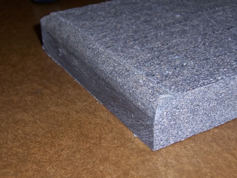

Mike it was over a year after I had it that I figured it out. I move slow. Jerry here is a picture of a trial router cut, not the one I am using. It worked beautiful. They ought to make me the official spokesperson for this stuff. :D It's not porous like it looks in the pictures. The only thing I don't know if it does better than wood is float. Need to cut off a piece and send it to David Letterman. Sink or Float? :D Image

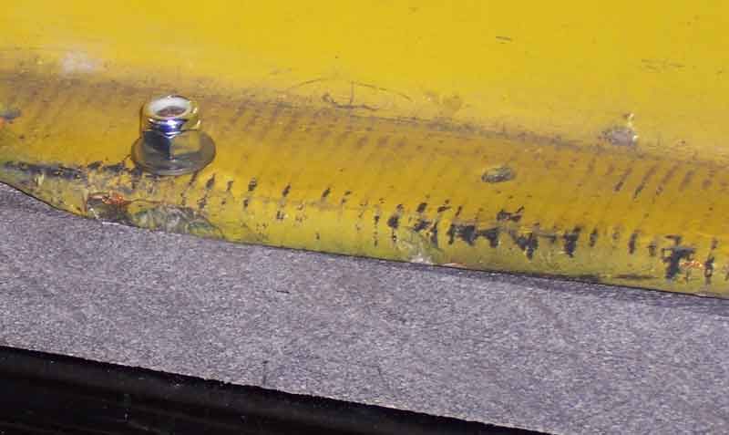

Got to work on it some today. First picture shows how it will fit on the inside. There is only one bolt in it but it will all pull down flush with more bolts. It will make a nice smooth transition from body to lift. Body looks pretty ugly on the inside especially at the bottom where the carpet was glude to it. Redo the body will be another time. Image Second Picture shows how close the body fits at the rear. Yea I see the chips. If the body was a 1/4" shorter or the frame was 1/4" longer it would be much easier to fit. It also shows how the lift block is cut to fit the body lip. Image

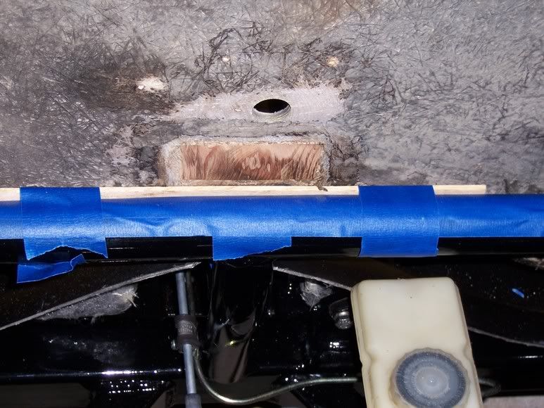

Side view, It will be trimmed to match once it is all bolted down and I know for sure where it is going to be. Image Shows how tight the body is to the chassis. One paint stick thick in the front about 1 1/2 paint stick in the rear. Thats about 1/8" in front and 3/16" for the right rear. Funny there is all kinds of room on the left rear. Are all bodies like that? This is the only one I have mounted. Image

Chuck, When I mounted my siggy to the Berrien chassis I had the same amount of room up front. My block wasnt cut flush and I had to work on that before mounting the body. With regards to the rear, there was definately some give in the measurments. (if you know what I mean?)

[QUOTE="fubar"]I bet that stuff saves a lot of hours and drill bits compare to the steel tubing....I can't wait to see how you do the section over the tunnel. looks good so far.[/QUOTE] Me too. The engineering department is still working on that. :confused: dpgregitis Quote: With regards to the rear, there was definately some give in the measurments. (if you know what I mean?) I know exactly what you mean, they could do a little better job with the fiberglass pan. Looks like it should be about 1/2" shorter.
