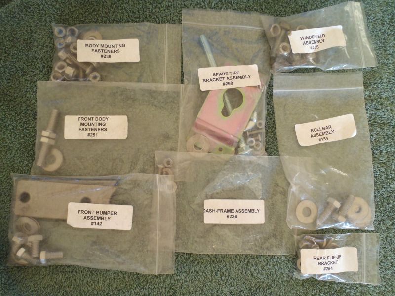

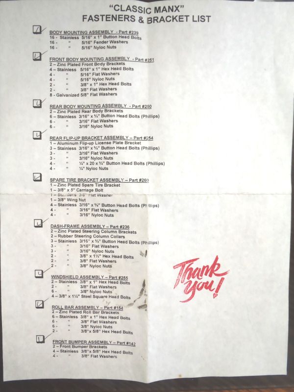

I'm putting together a show board for my garage wall like this one. I've got all the major peices to go on it now (except for Bruce's signiture badge and the big sticker 'cause I doubt I'll ever get those), but I was just wondering if anyone had a list of the nuts and bolts that came supplied in the little baggies.

Hey David - Let me check what I've got. I think I sill have the little baggies the nuts and bolts came in and I think they are labeled. There might have also been a packing list with everything listed. I let you know next week as I am heading out this afternnon for Minden.
I finally got a chance to look through my stuff and here is what I found for you. It looks like how things were package for the kit vary a little bit from the board, but it should help you figure out what you need. Also, I think it will be a cool piece of 'garage art'. Make sure you post a pic of it when you are finished.
