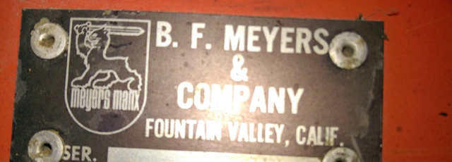

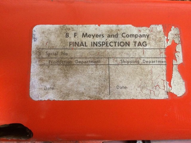

1. Yes this is an original Tow'd, although the tag indicates that it should have been powder blue.... it appears based on another forum that there were a bunch of tubs that were swapped out from the ABS and they all were competition orange...
It was also a nice surprise to find the original inspection sticker under the spine.

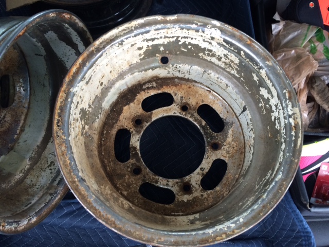

As for wheels - well I loved the look of the wide 5 slotted mags that came on the front of the Tow'd. They are 14 x 5. My mission to find matching rears worked out unexpectedly well. I did some "pre-shopping" prior to heading out to Ohio to meet Bruce and Winnie at the All Air-cooled gathering. Thanks to Craigslist, I found a matching pair of steel wide 5 slotted mag rims. They ended up being too wide for what I wanted, but a couple of "Good ole' boys" actually drove the pair into the "Big City" and met us at our hotel to deliver them even. That was a 1 1/2 hour drive for them one way for a pair of wheels that cost $50. I was thrilled! Thanks to co-workers that are racers here, I was able to find a somewhat local wheel repair specialist that was able to narrow them down to 15 x 8's for me. On a side note, they also made me my offset smoothies for my Manx. All of these get picked up next Monday. Here is what they look like both before when I got them as well as once they were cut and partially blasted.746745

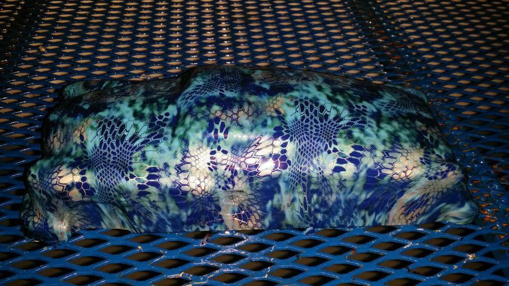

The biggest question to date is color.. I havent really mentioned that yet. Well I can tell you what family it will be in, but I wont know exactly till I get my peripherals back from TJ Kustoms.... one of the personalizations that I have chosen to do is hydro-dip a few things....the color of the Tow'd will get coordinated with the bright turquoise in this print.
