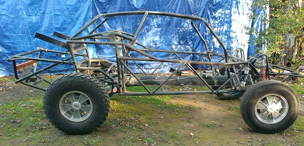

- Attachments

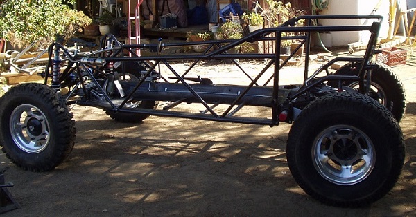

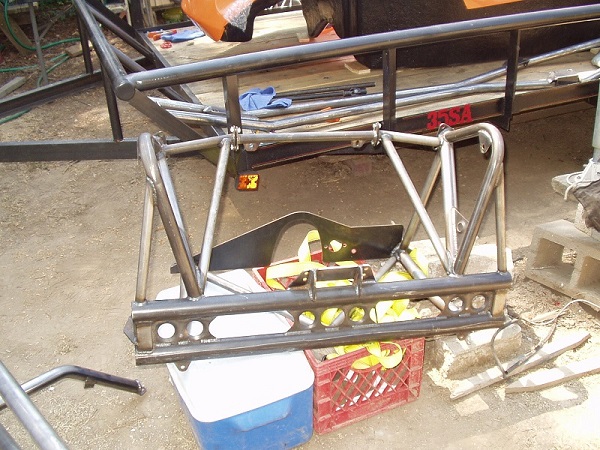

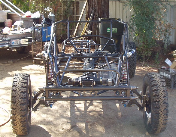

- As chassis sits now with all the steel parts with out the body
- chassis with roll cage and front and rear bumper right side reduced size.jpg (127.89 KiB) Viewed 12878 times

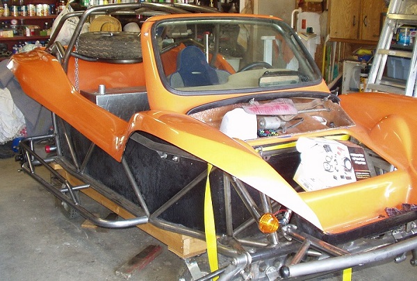

More pictures

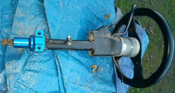

some more pictures (only allowed 3 pictures at a time for some reason)

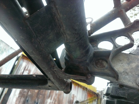

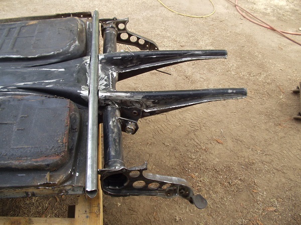

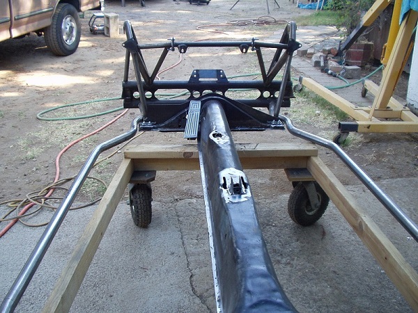

Looks good, great to see what goes into a DualSport Manxter Build.
I noticed your rear cross support tube where you notch the frame horns fwd of the torsion housing, have you ever seen any issues with cracking by doing that ?
From memory the VW 181 has a support on the housing which is where I put the setup for the DualSport Baja Edition but I had never considered going fwd like that, interesting.
Keep the pics coming
- jsturtlebuggy
- Posts: 652
- Joined: Wed Apr 07, 2010 5:00 am
Re: Manxter Dual Sport DS-17
The reason I sunk the tubing into the frame horns was when tying in the outer frame tubing it would be the same height as the stock pan height. No cracks. Also the outer ends of the round torsion housing are tied to the tubing with a 1/8in thick flat plate. I don't have pictures showing them yet. Once I get further in taking apart the chassis, I will post them.
Yes the type 181 (Thing) had a welded on channel on the bottom of torsion housing, It was the same thing done to the type III models. I have seen a few torsion housing break over the years (even on street buggies). This is in the area where frame horns are welded to round torsion housing.
The little bracket that at the ends of torsion housing (near spring plate covers) that ties into edge of pan, break. One was broken on my Kick Out before I rebuilt, you could hear it squeaking. I reinforce area with a couple of angle pieces welded between the housing and floor pans edge. I have to look for the pictures of them to show what I have done.

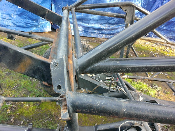

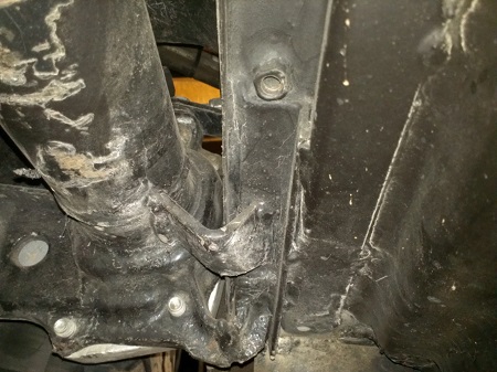

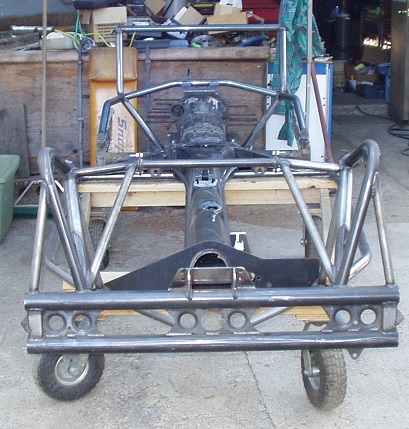

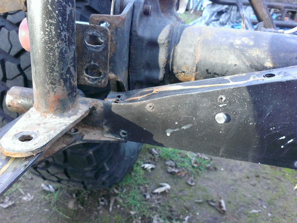

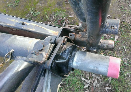

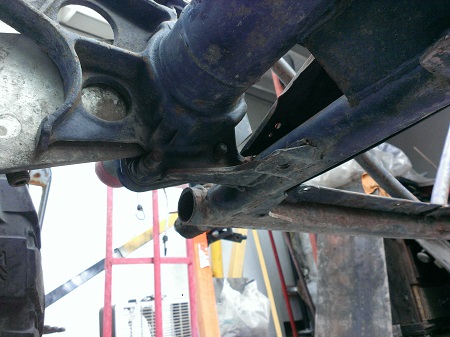

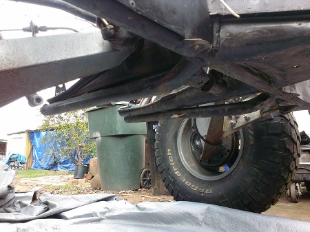

Here are a few pictures of the reinforcement to the torsion housing and frame horns. I use premade triangular gussets for tying in the outside edges of torsion housing to the 1 1/2in cross bar. And a piece of 1/8in plate about 4in long to tie the housing to cross bar on each side between frame horns and outer ends.
When I first build the chassis I was using a 10degree mount for the Bus (type II) 091 trans which set trans lower in frame horns. With it being this low, I want to make sure it had clearance between skid plate. Adding a piece of 1 1/2in tubing that was bent to fit to forward cross bar. The skid plate is made of 3/16in diamond plate aluminum that the front edge in formed to follow the tubing.
I cut the factory stops for spring plates to get more downward travel. The lower rear spring plate bolt is used a fail safe stop if something happens to the limit strap that I use to limit downward travel. Plans in the future is to use a Micro Stub set up which will allow for more downward travel. They make torsion caps that have one bolt hole that is further apart to allow for spring plate to travel further.
- Attachments
- frame horns reinforcement tubing from right front angle reduce size.jpg (76.73 KiB) Viewed 12782 times
- left side torsion housing gussets reduce size.jpg (69.79 KiB) Viewed 12782 times
- right side gusset for torsion housing pic2 reduce size.jpg (60.85 KiB) Viewed 12782 times

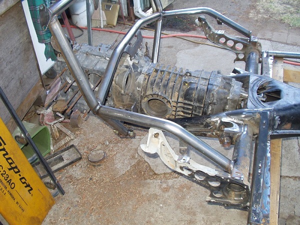

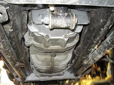

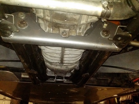

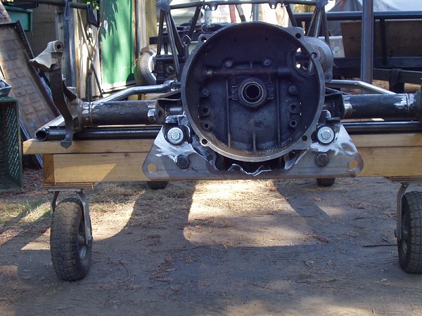

More picture of the torsion housing and trans mounts. The reinforcement tubing on frame horns butts up against the rear trans mount. With rear bumper cage attaching to rear trans mount inline with the tubes it makes for a stronger setup when hit in the rear.
The front trans mount on the chassis for the 10degree mount I was able to reuse with mounting of the 091/1 side shift trans. Trans is position as low as it can be placed. It did require removing most of inner seam on frame horns. With the 10 degree mount and a 002 or 091 trans you also have to remove sections of the seam for trans to fit.
- Attachments
- rear trans mount for 091-1 trans reduced size.jpg (82.89 KiB) Viewed 12778 times
- front trans mount for 094 trans reduce size.jpg (93.96 KiB) Viewed 12778 times
- 094 4speed mounts from underneath from rear.jpg (63.23 KiB) Viewed 12778 times

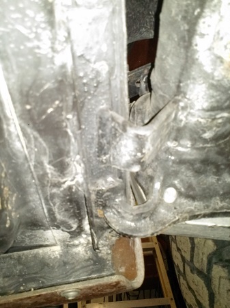

To add more strength between the torsion housing and stock steel floor pans on the Kick Out, I bent a couple of pieces of 1/4in flat stock to weld in place. Why I did it this way was to be able to attach to the steel reinforcement in edge of the pans. As you can see in one picture of the stock cast steel bracket from torsion housing to pan on left side has been welded because of it breaking in half.

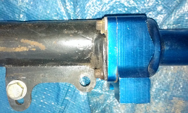

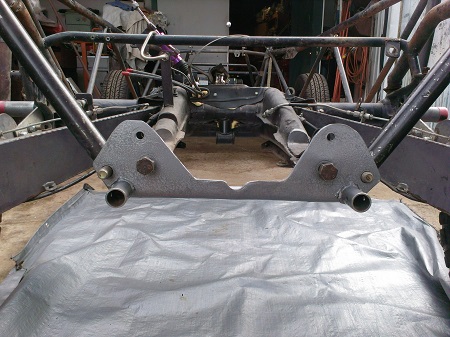

On the Dual Sport Manxter cage there are attachment points to the torsion housing. They bolt to torsion housing using 2 of the spring plate retainer (cap) an 2 bolts to a bracket on B pillar of cage. Tying the two together add strength to whole structure. I did have to grind on the outside of the body where brackets contact to make a flat surface for them to set. With the cage tying into the outer steel structure parts it makes it makes it very strong.
