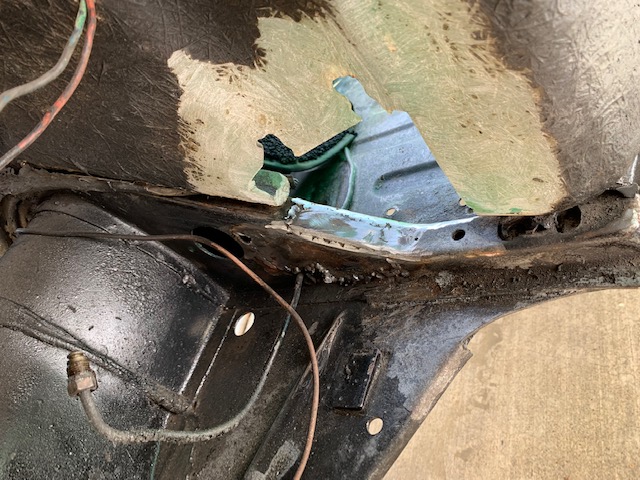

Another option would be repairing this section to accept a clutch master next to the brake master.
These are big holes to fill. If I just repair the admiral's hat I still need fiberglass repair and paint. At that point it might be better to extend the steel up to meet the fiberglass after cutting the glass straight. That would give lots of strength and would give plenty of room to mount a clutch master.

why not, your repair plan sounds good. your almost done, here's some pics of my 3 DESERTER GS for encouragement , all vw stock power.5584558055825572 don't slow down now!

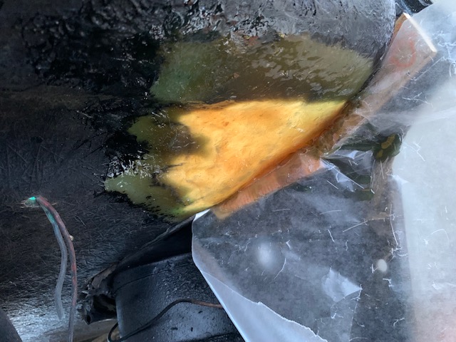

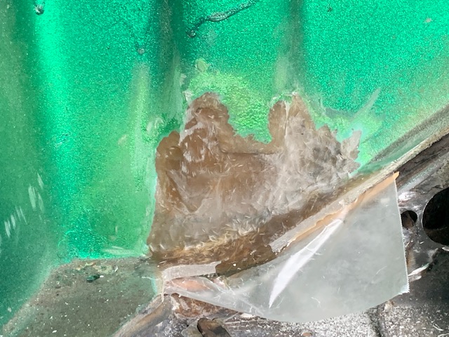

It's been a while since I posted but I am making progress. I made a splash mold from another buggy and used it for the general shape of the repair. Once I had that I fixed it to the front side and added a layer of wax paper and starter laying down resin and fiberglass.

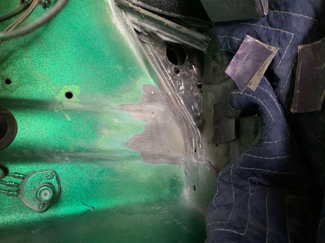

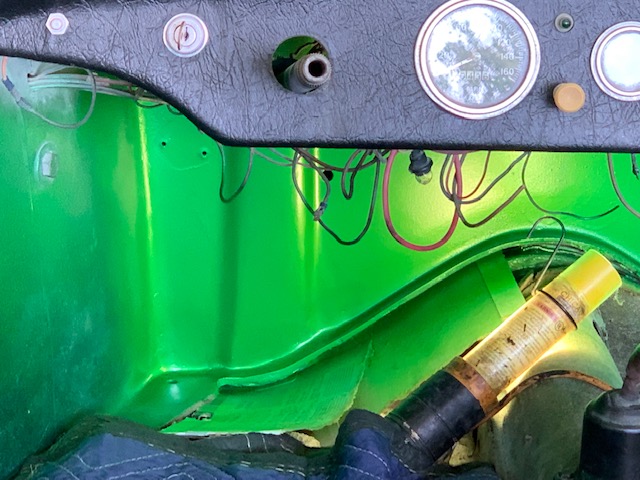

A little sanding and some paint and the hole is now gone. The paint match is not ideal but the area where it's blended is covered by upholstery so will never show. There is also some black over spray that makes the older green look a little different.

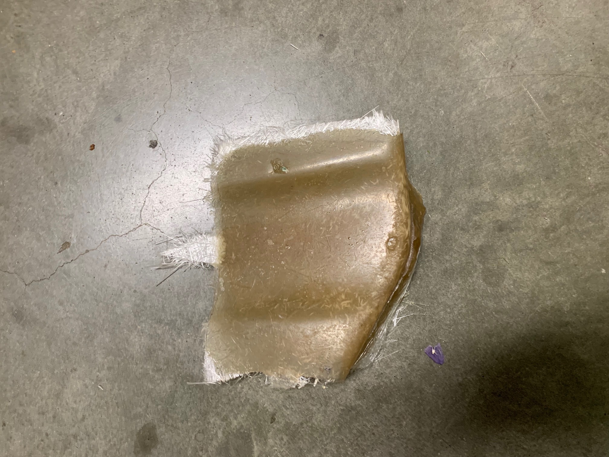

This was the splash mold I made and used for the repair.
