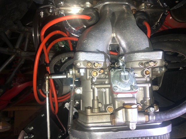

I'm not to sure, they look like the HPMX carbs. The "D" series have a vacuum port on them and mine do not. I don't have any jets for them. do you happen to know how can I tell for sure.

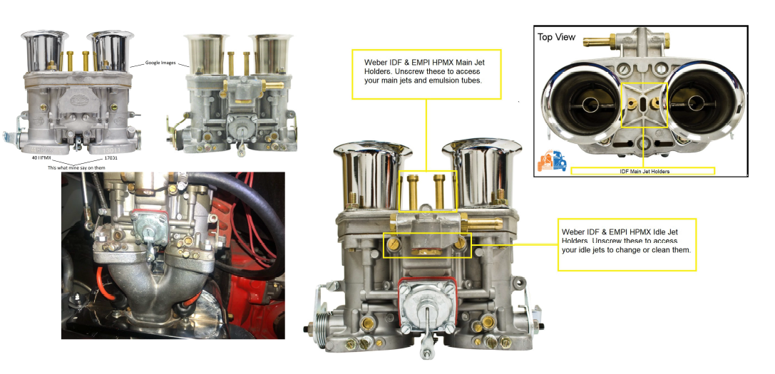

I think I figured it out, did some research on Google this morning and came up with this. Now I just need to come up with some Jets. Looks like the EMPI carbs are 40 HPMX

The Empi Hpmx carbs are copies of Weber IDF and use the same jets as them.
Depending on were you live you should be able to find jets for them at places that sell VW parts.
Shops such as Pierce Manifolds in Gilroy, Ca sell Weber parts and jets, CB Performance in Farmersville, Ca sell Weber parts to.
If you are in Southern California there are many shops that sell jets.
The idle jets are the small one by the fuel inlet valve.
The jets have numbers printed on them. You will see numbers such as 50,55 on the idle jets.
This measurement is in millimeters.

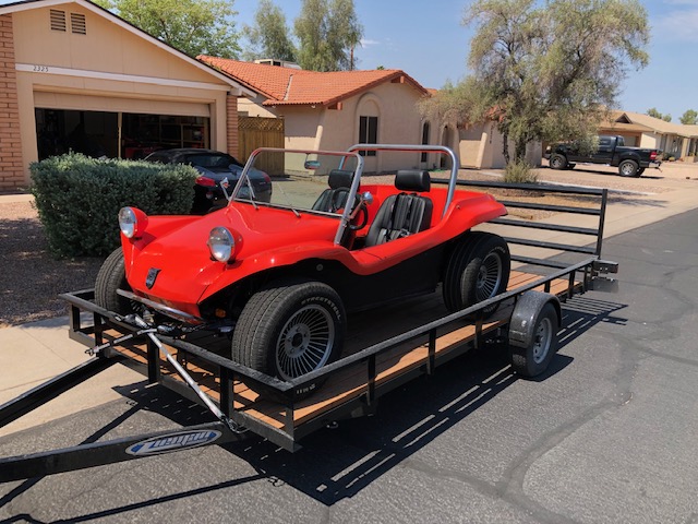

Here is my 64 Manx, it's pretty complete and I've tried to keep it period correct. It's about 95% garage build by myself.

Nice Manx you have there. Yes could try the smaller idle jets at home to see if it makes any difference in the way it runs.
With the idle air/fuel adjustment screws should be about a 1-1/2 turns out on the average. If your turning them out more, it means idle jets are to small.

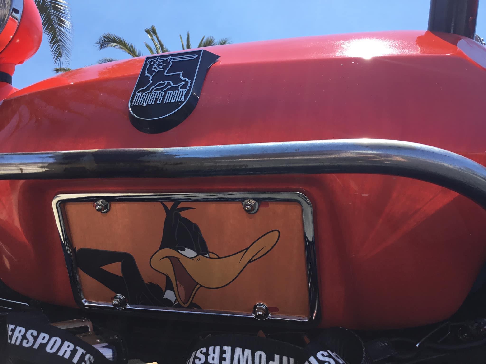

Thanks again for the help. I feel like I'm heading up there prepared now. I was not able to come up with a EMPI carb sink tool so I'm now a bit hesitant to mess with it but if I have issues I'll be ready.
Looks for me on up in Big Bear, my front lic plate is Daffy Duck.
